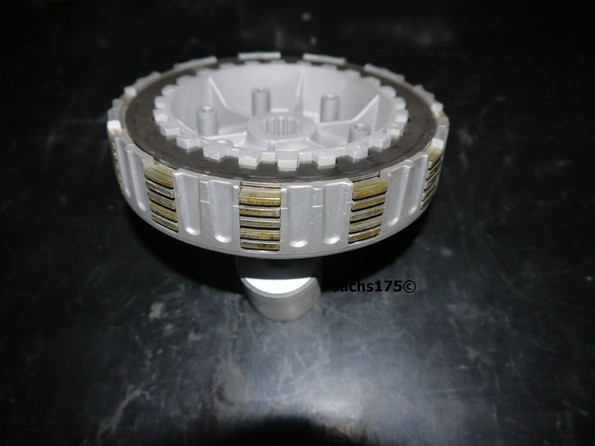

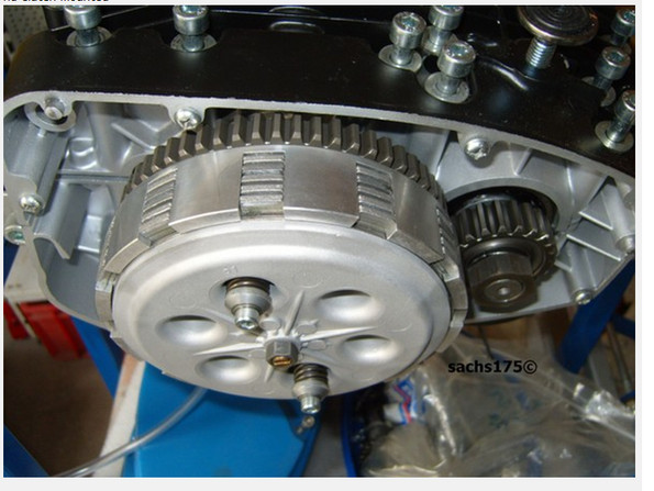

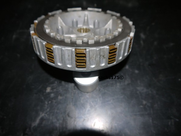

Hello Guys

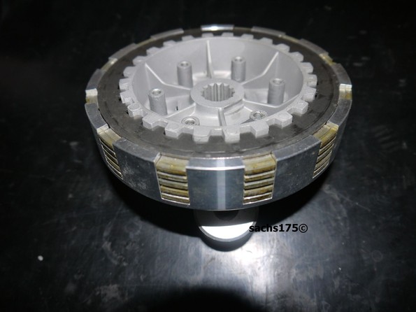

everybody knows the small wings which are laying down in the engine case .... . This wings are coming from the clutch plates and this bullsh** things will destroy the whole primary drive a.s.o. .
Here are some upgrades for your Sachs engines that this never happens again:
the old clutch plates and clutch basket
the new clutch plates and machined basket
the new HD (specialy for racing) cnc machined basket
the difference between the old and a original machined clutch baskets
hd clutch mounted

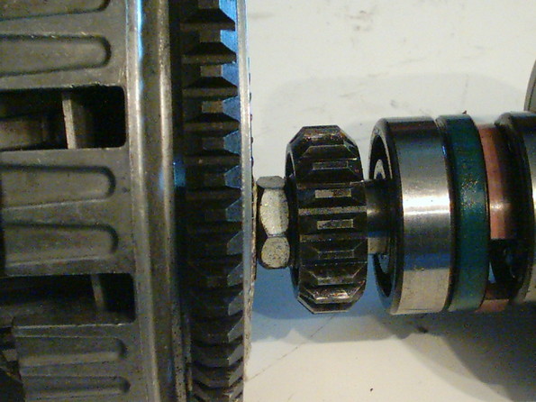

Ok! and now the transmission seal upgrade (for cone shafts 7v):
old seal
the new alternative and no overhang by a seal by using a spacer
mounted alternative seal housing with new seal
hd clutch mounted
old seal

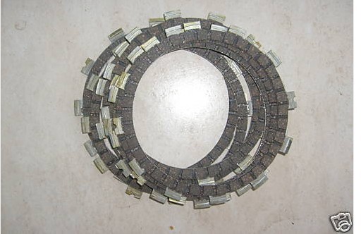

Clutch friction plates are Yamaha . But the original Yamaha friction plates are to expensive so i use aftermarket from EBC Brakes (Part no: CK2240). Steel plates are original Sachs.

Ça c'est une bonne nouvelle...à priori identique à EBC Friction Clutch Plate Kit CK2240 YFM400 N 00-03
