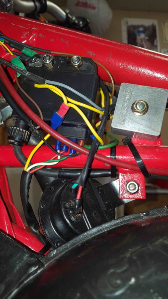

Damaged ignition
Erbers
Messages : 17
Enregistré le : 07 avr. 2020 07:42
Message par Erbers »
perfect !!!!

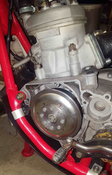

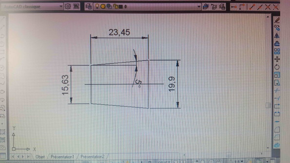

Bonjour et bienvenue sur le site.
L'allumage Ducati pour moteur Minarelli AM6 fonctionne parfaitement
Il faut modifier le cône.
Il faut aussi choisir un volant magnétique avec la couronne pour le démarreur électrique pour augmenter le poids puis il faut usiner le sommet des dents.

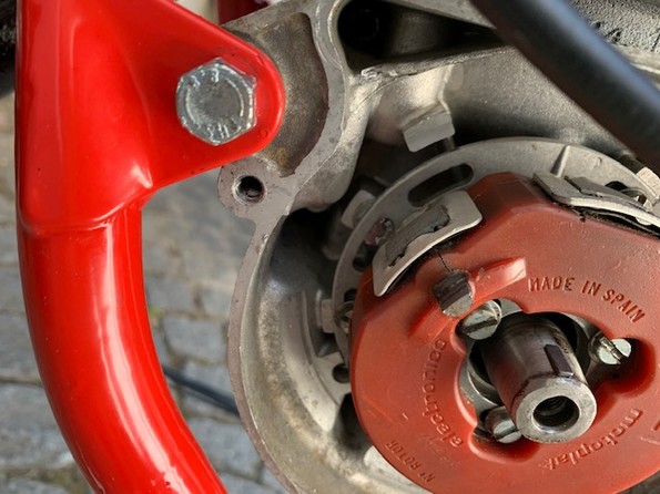

it should works , I have this ignition on my RX 125. :clin:

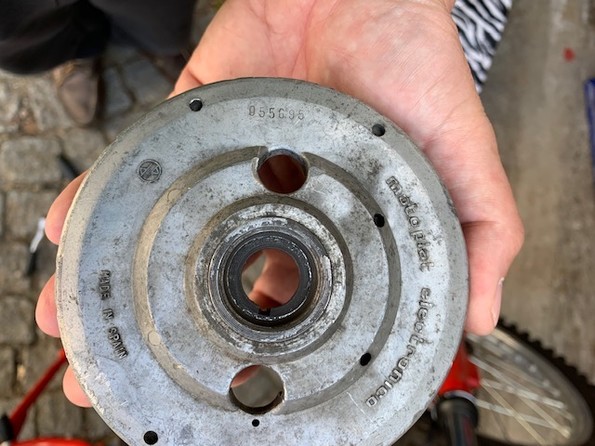

Erbers
Messages : 17
The conus is the problem, I will try AM6 :)
Merci!!!!!!!
Rolf
Messages : 3784
AM 6 , Minarelli. :clin:

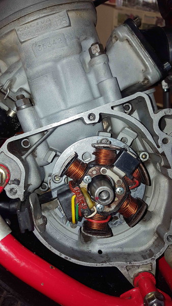

Messages : 3784
Hello .
there's some Ducati ignition which fits to the RX /WRX .
Maybe you' ll just have to modify the rotor's cone.
I inquery to know the model , and I 'll tell you. :clin:

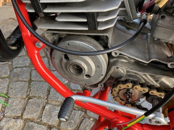

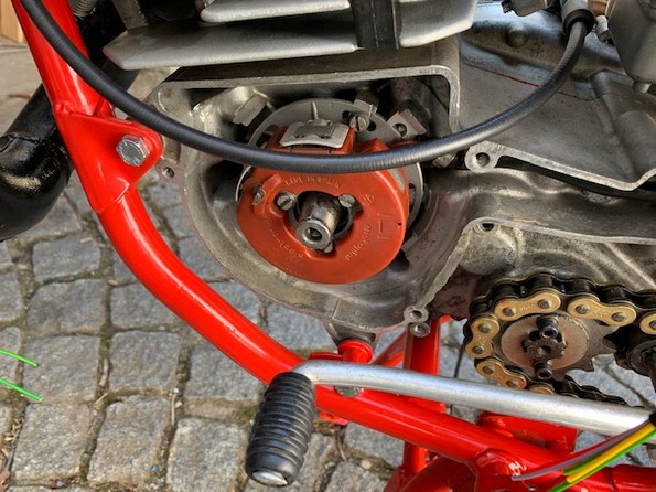

Hi all together,
I have a problem with the ignition of my RX 125.
Insite is a Motoplat Ignition, it is broken an I want to change it with a 12V or 6V Ignition.
In earlier times you could buy an Ignition from powerdynamo, but now on the Vape webside, there are only ignitions for a wmx, ignition on the right side.
Does anybody have an idea?? Where can I get a ignition for my RX?
Thank´s a lot!!
Greets Rolf
