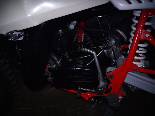

I have been doing some more jetting work with this carb on my 175. I have now gone to 52PJ & 145MJ.
The bike goes much better with the PWK than the Mikuni.

It needs a sleeve. The air boot is for a Dellorto. I have used the same sleeve I was using for the Mukini.

Does it fit the airbox rubber perfectly or did you had to make a sleeve?

Thanks for sharing your experiences. As Keihin PWK are generally very good carbs, it should work fine.

I have put a 35mm PWK with a 45PJ and 160 main on my 175. It is great much more low down power. Will be racing it next Wend so will let you know how it goes.
