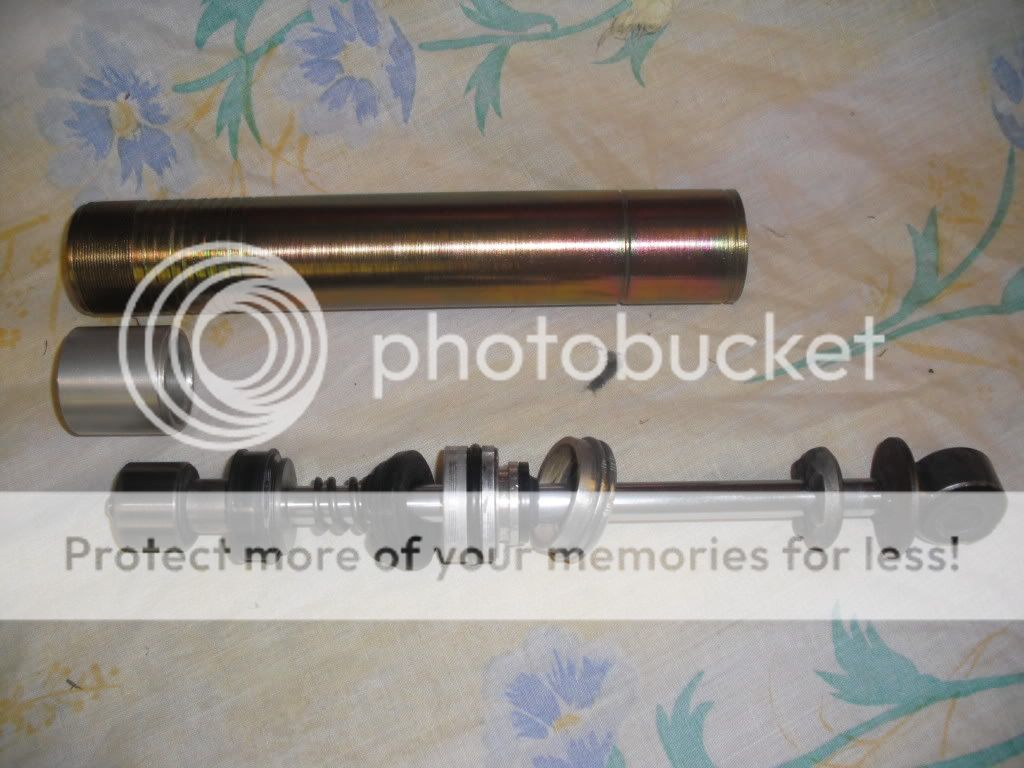

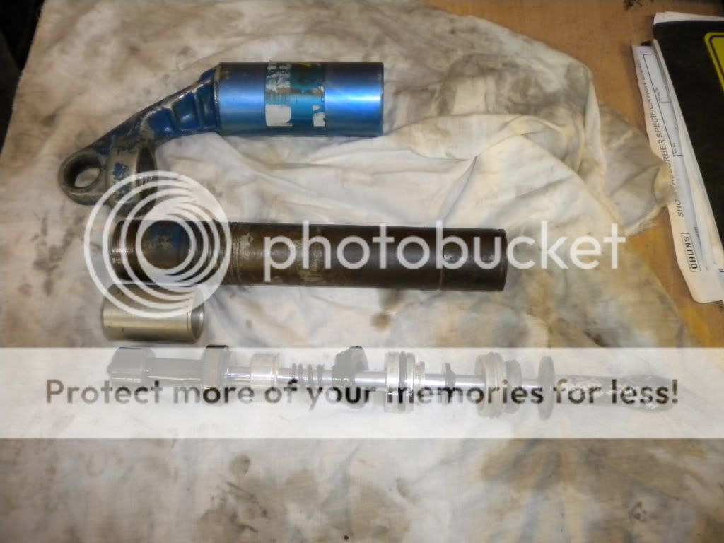

you have cut the final hydraulic piston
No, just the spacer between shims and the piston.
The original shocks were Marzochis and not very good ones.
I have done some testing, they work very good.

Oui,plusieurs personnes font deja ça,tu vires le piston corte et Cosso,tu mets un piston et clapets Olhins,et tu remplis ça avec l'huile Ad'hoc...meme principe que le montage Corte et Cosso,donc sans probleme...

Yes,nice modification,you have cut the final hydraulic piston :clin:

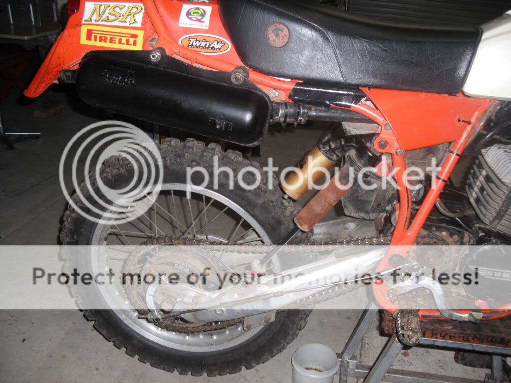

Rebuild shocks

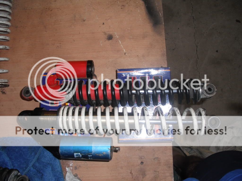

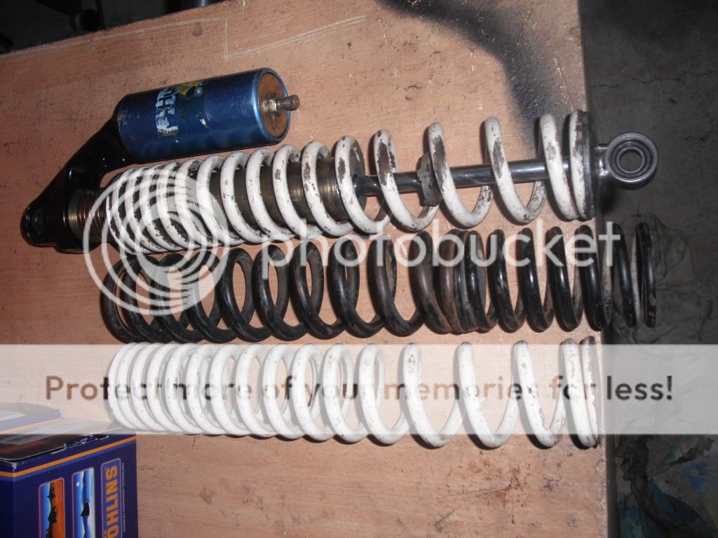

The red shocks came on the SWM.

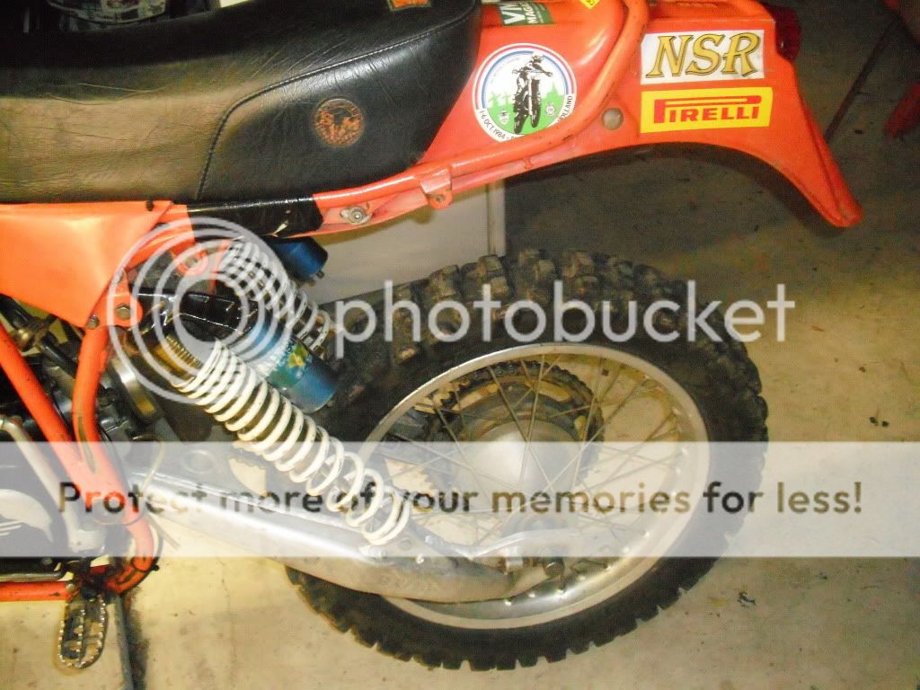

Here they are with the ITC springs.
The ITC springs were too soft so I put a set of duel rate springs.

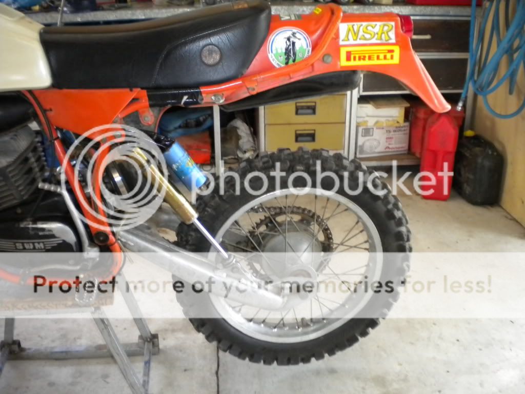

Even cut down by 20mm the hydraulic bump stop works and they have made the SWM even better to ride.
Cheers
Noel

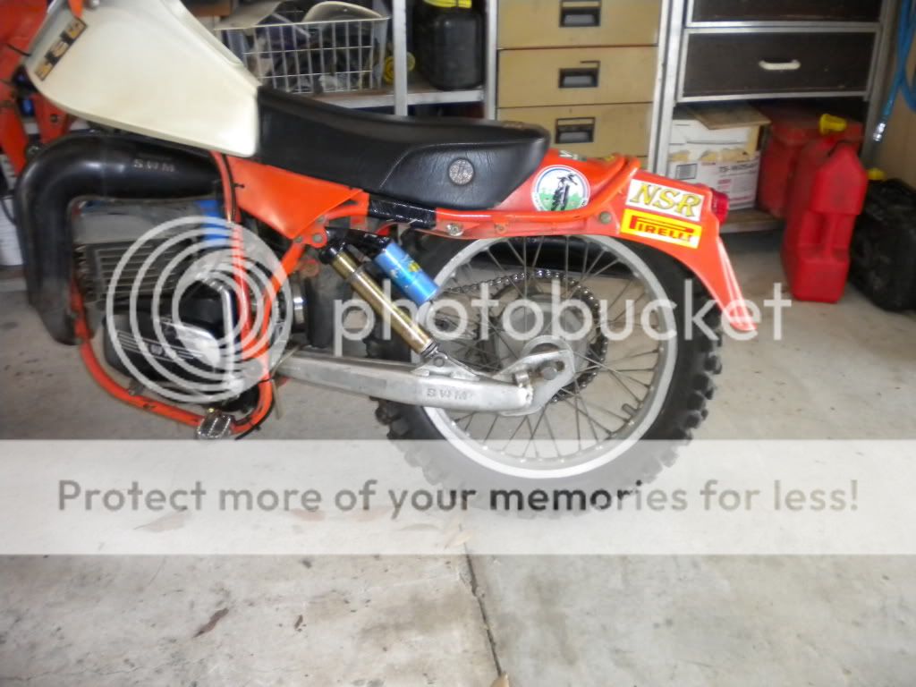

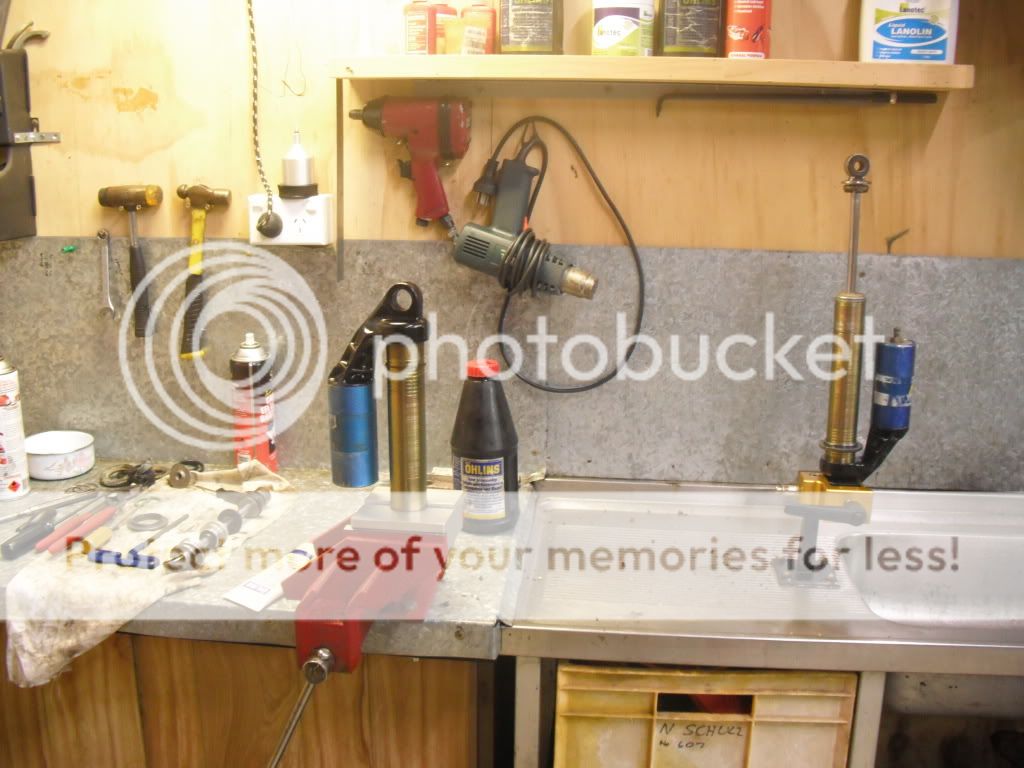

I have made a set of Ohlins ITC HVA shocks fit my SWM.
The SWM needs 420mm shocks. This is a standard ITC shock.
These are 420mm Ohlins, just right for the SWM
On the ITCs I have cut down the body, shaft and hyd bump cup by 20mm. I have also removed a spacer and changed the bottom eye.
This brought the length back to 420mm.
