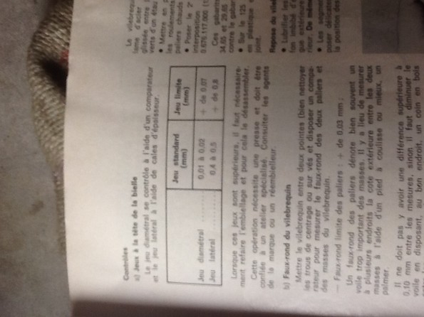

Les roulements de vilo et joints spis ont été changé,la bielle et le piston sont ceux de la machine a l'achat. La casse est là mais je ne trouve pas le morceau qui a occasionné ses marques sur le piston :hehe: :hehe:c'est cela qui me chagrine !!!

0.40 will be ok for a used crankshaft . But 0.50mm is absolutly to much . It's a half mm ! At that point the conrod could be turn over to a diagonal gap and that's not pretty . That means a high wear to the piston and bearings and specialy to the crankpin . The force which comes to the crankpin was not spread to the fully face of the crankpin . The result of it , it will crack sometimes . You can check it out easily if the conrod is working properly : pull out the wristpin and check the surface of it . Measure it at that point where the bearing is working ..... if there is a difference from the right to the left so the conrod has to much gap and it's diagonal overturning .
Iam kicking out crankshafts with more of 0.42mm gap . Sachs is talking a piston gap for the 125ccm/7speed engines of 0.04mm ! That's absolutly to tight . All piston will blocking .

Le jeu latéral pour un vilebrequin de 125 est au maximum de 0,35mm. Toutes les autres spécifications sont fausses.
Le jeu au piston pour les pistons KS (Sachs) d’origine est d’environ 0,05mm (0,06mm pour les Wössner) »

Conrod gap sideways for 125 crankshafts is max 0.35mm . All other specifications are not true . Piston gap for original KS (Sachs) pistons are about 0.05mm (Wössner pistons : 0.06mm) .
