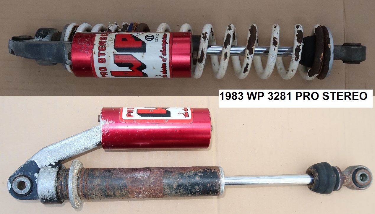

These WP are not actually very, rare except for in countries outside europe when you know where to find them LOTS were made and i have many of them. In terms of the 1977 to 1983 style twinshocks, they are ok/good but are let down by the smaller 31.75mm ID body tube so they contain less oil compared to Hulco/Ohlins/Corte & Cosso/Reiger and other brands that used 36mm ID at the time. The reservoirs are fairly short so increasing the length can gain a little more oil capacity. They also use a horrible seal head set up that is extremely hard to disassemble, they dont use a low friction DU bush and instead of a rubber internal top out like Ohlins, they use a metal spring and these are prone to breaking. They also use an odd size shaft that is 12.43mm.
By 1983 WP improved the design of these shocks a little, better piston, rubber top out, a floating piston to replace the bladder and a spherical bearing in the lower mount. This design was called 3281 'Pro Stereo'
PRO STEREO.jpg (270.38 Kio) Vu 919 fois
and they were only made for 1 -2 years before a totally new design came in late 1983 with a bigger 36mm body, better internals and external rebound adjustment which were called '3612', By late 84/85 they further expanded the design with external compression adjuster. At the same time there were remote reservoir designs with and without external adjusters too.

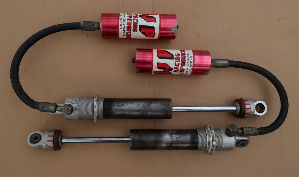

Here is the remote reservoir WP 3612. This version was also available with adjustable compression on the reservoir

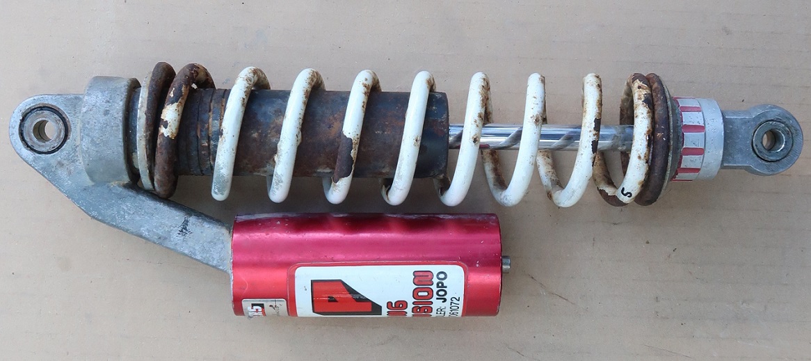

Here is the WP 3612 from 1983 onwards with just the rebound adjuster. Although it looks similar to the 3281 Pro Stereo shock virtually nothing is interchangeable besides the reservoir.
3612 piggy.jpg (208.32 Kio) Vu 916 fois
Unfortunately i only have one of the 3281 Pro Stereo versions and i am attempting to find or make the parts needed to make a second shock.
