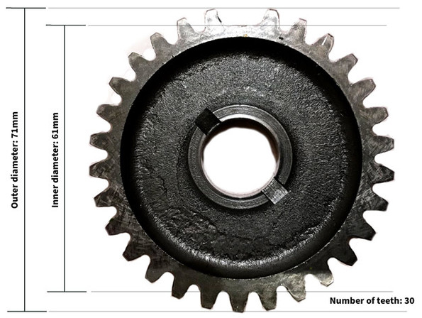

I did a proper photo and measurements this evening too on my current 30 tooth relay cog.

Yes I understand this particular part was changed or updated in later models of the RX and MXR. I understand the earlier models had 30 teeth and then later models from 1981 had 29 teeth. The part number gets updated from 800023590 (1980 parts manual) to 800034305 (1981 supplement parts manual).
It could work but I think I would need to change the gear it works too because of the difference in the number of teeth.
