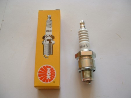

Hi everyone.
Im looking for the type or code of NGK spark plug for FANTIC Caballero Enduro competition 50cc 1982.
Please , write the exact code , my dad told me that once , someone told him to put a spark plus which wasnt good for this engine , and it melted into the engine! :hein:
Thanks alot guys!

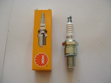

Following your cylinder-head
short plug NGK B8HS
long plug NGK B8ES
O Dédé

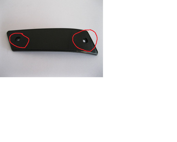

I have another question , this time its about something else.
where can I get these screws? or what kind of screw is it?
Modifié en dernier par Dean Nevo le 06 sept. 2013 00:12, modifié 1 fois.

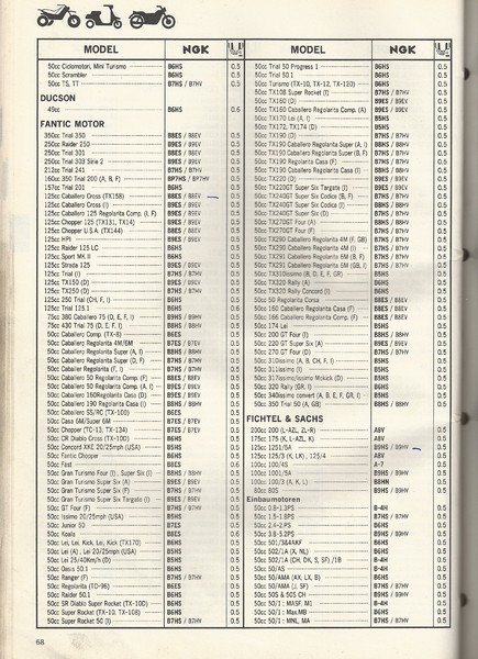

bonjour voici un extrait du catalogue NGK de l'epoque
