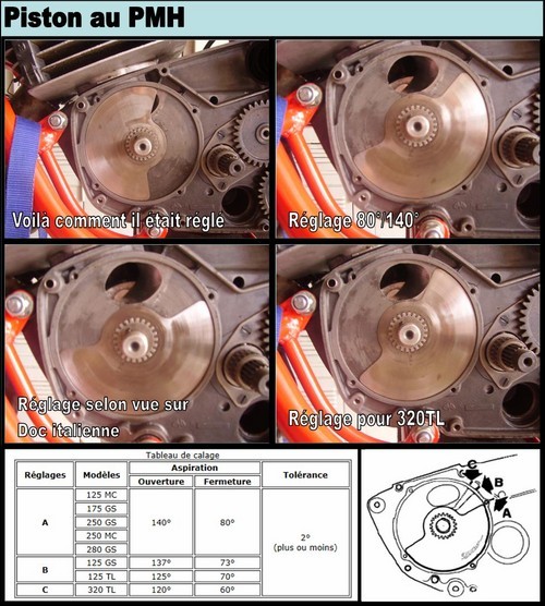

Hi
You can use all Disc and change the feeling of your rotax
Friendly
Jean

Thank you very much for your information.
I heard that late in 80's some people used to ride with the trials disc, from a TL.
They say that a low rpms works very well, and also it does at high rpm.

My engine is a 250cc short stroke.
Jean have certainly more experience than me in enduro version. :clin:

hello,
I ride with an mx SWM and I have a 172° disc. It's not a good configuration for an enduro use.
For me the good one is 155° to have a big torque at low engine speed.
Modifié en dernier par FCAUV le 13 févr. 2017 20:54, modifié 1 fois.

welcome on board
for enduro I use 162
friendly
jean

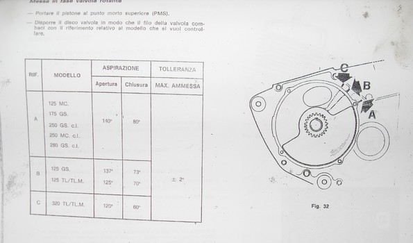

Somewhere I've found that there are several configurations of this discs..............from 155º to 162º. Could someone please let me know what is the best for enduro riding. Or at least what is the OEM?
I found my bike character a bit rude.............more motocross bike than enduro, and I think that probably is because the disc.
Thanks in advance.
