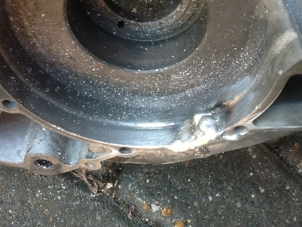

Thanks All for your input. Thanks Martin I will be interested later in the year. I will be in England in September.
With advice from someone with a lot of Rotax experience, I have had the case repaired. It is not an ideal fix but it works with the time and money I have at the moment.
One question, What gear should it be in when the gearbox gets installed?

- Messages : 239
- Enregistré le : 02 janv. 2010 13:12
Thanks for the comments.
With the chances of obtaining a left case almost nil. Has anyone fixed damage like this?
I am thinking maybe fill the holes with weld and then have it milled where the disk runs.
I know this not the best solution but it may be the only one.
Cheers
Noel
Cheers
Noel

- Messages : 412
Indeed you are not alone...
Just repaired a customer 250 RS.GS motor after having the same 10mm nut traveling this time through the disc valve straight to the bottom of the crank (at least saved all the top end)
So, result, magnesium welding needed and a lot of filling and liquid paste to ensure no leak in both half casings.
Unfortunately, as much as we love SWM, the matter of dismantling often the air box to work on the carburettor or change the rubber boot, have to too many owners been an expensive mistake when refitting these nuts.
Do not feel too bad, welcome to the club! :clin:
Cheers, Ph.

Or what a complete idiot I am!! :quoi: :quoi: This weekend was to be my first ride for the year.
It is simple really, just leave a 10mm nut in the air box
Lucky it was free revving and not under load at the time it stopped.
Should I attempt to fix these gouges or would it be better to leave them?
