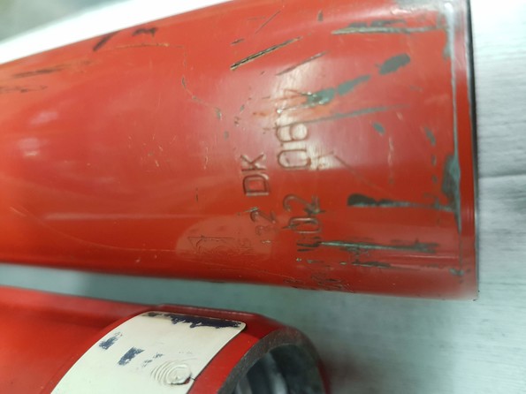

j'ai les même SACHS HYDROCROSS ( même référence )
mais ils ne sont pas repris dans le manuel de réparation trouvé ici ?
pouvez vous me donner la quantité d'huile à mettre dedans
on ne voit pas bien mais il est inscrit BZ 32 x 132 DK 06 2400 102 061 SX

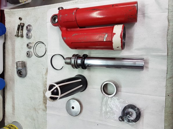

hi guys its me again
today i've been working on the Hydrocross..and I really dont know what air pressure should I put in it.
thanks alot! :D

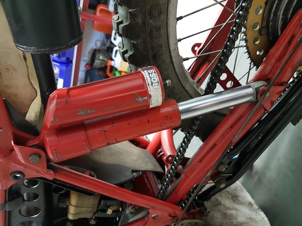

Dean, I don't have th2 390 mm listed in my technical procedure, but for the 375mm long, it stipulates between 280 - 345 cc. k

hi guys.
the number of the hydrocross is:
BZ 32 x 132 DK
06 2400 102 061
sx
Messages : 27258
Hello Dean,
Didier was speaking of a number written directly on the "corp" of the shock absorber , not in a manual. If you get this code, he will be able to answer you more precisely.
About your question on the oil fork, i use personally special oil fork with a grade of 10 or 15 it's ok for these old Marzocchi's.

Hi Dean,
I've got the repair manual in pdf file, but in French, sorry about that :cool:
But, if you tell me what is the length of your shocks and if they're the pressurized type or standard, I'll be able to answer your request.

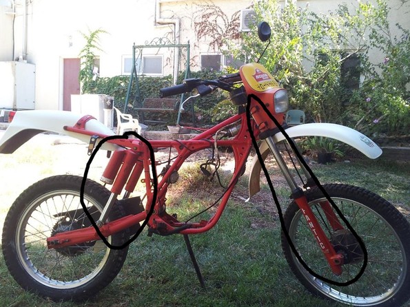

hello everyone
what is the oil quantity that should be filled in the hydrocross?
and what is the oil quantity that should be filled in the forks of fantic?
these are the original suspension which came with the fantic enduro competition 50/75cc
another question , what type of oil os the best for these Marzocchi forks?
thanks for the answer :)
