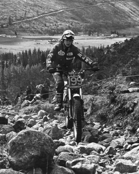

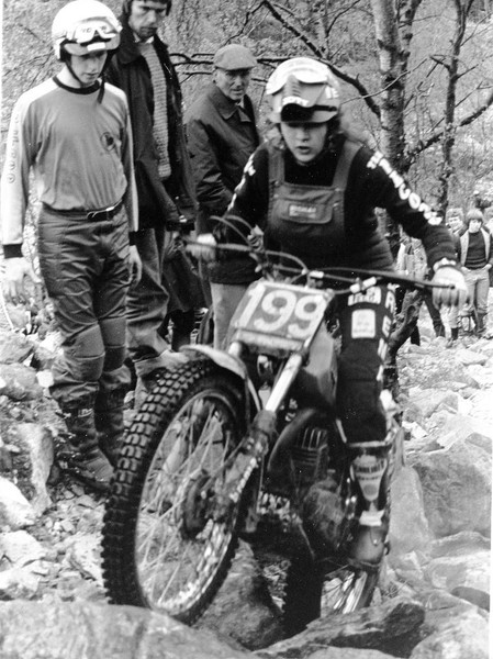

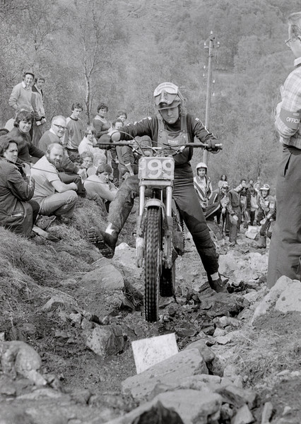

200 SWM Peco Special
*Photos courtesy Mr Derek Jones
The 1981 200 SWM ridden by Miss Lisa Jones in the 1981 SSDT riding number 199.
At that time she was the youngest female ever to have completed the trial.
All you older trials riders will remember this was the year that Giles Burgat won on an SWM.
This bike built and developed by her father Mr Derek Jones
started life as a 125cc and was converted to a 200cc by removing the cylinder sleeve, and boring out the barrel to accept a larger sleeve and piston.
All parts used were Rotax.
Additional changes included a 900 gramme ( 2 lb ) additional press on flywheel weight, the carb' internals changed, timing cover spaced out , and 320 SWM bash plate.
All original SWM no pattern parts fitted.
Forks changed to Betor.
Other mod's that some of you will recognise including a grab handle on the rear silencer( pretty essential ) and Fantic foot rests.
"PECO" is short for Performance Equipment Company in buisiness during late 70s and early 80s with an SWM and Fantic dealership. Happy Days!
This bike was tested by SWM works rider Danilo Galeazzi and modifications approved by SWM bosses who were at the 1981 SSDT.
Danilo Galeazzi shown testing the bike around the SSDT Parc Ferme.
After the trial the engine was stripped down there was no sign of wear but as the barrel was off the bore was lightly honed and new piston and rings fitted.
*Photo courtesy Mr Iain Lawrie
