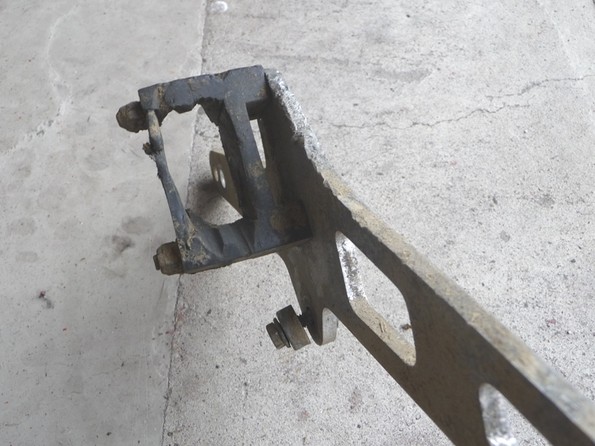

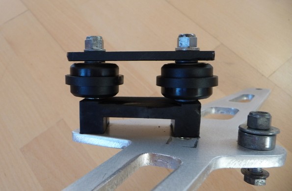

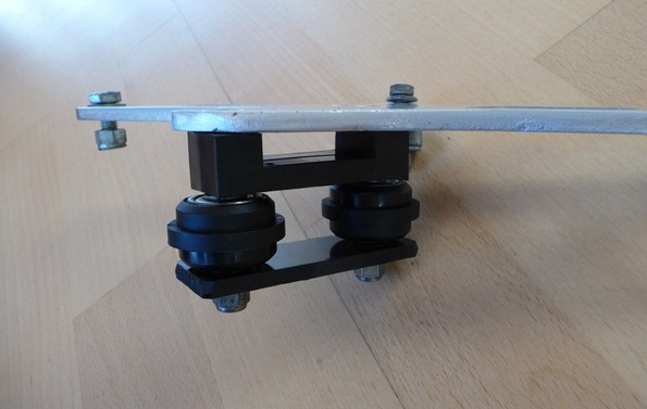

I think I have a good solution for the chain guide and guard. The new solution is based on the old parts, looks very similar, but is much more durable and creates less friction draw.
It is based on ZAP parts for a 2007 KTM. A bushing is needed to adapt to the inner diameter of the ball bearing.
Take it or leave it.
