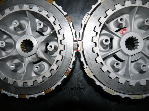

Hello Guys
everybody knows the small wings which are laying down in the engine case .... . This wings are coming from the clutch plates and this bullsh** things will destroy the whole primary drive a.s.o. .
Here are some upgrades for your Sachs engines that this never happens again:
the old clutch plates and clutch basket
the new clutch plates and machined basket
the new HD (specialy for racing) cnc machined basket
the difference between the old and a original machined clutch baskets

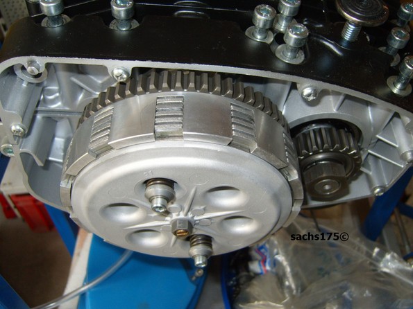

hd clutch mounted

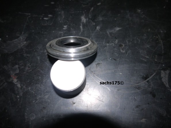

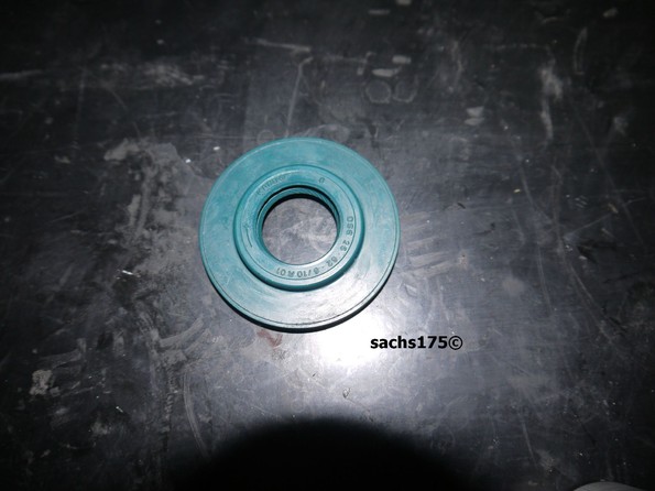

Ok! and now the transmission seal upgrade (for cone shafts 7v):
old seal

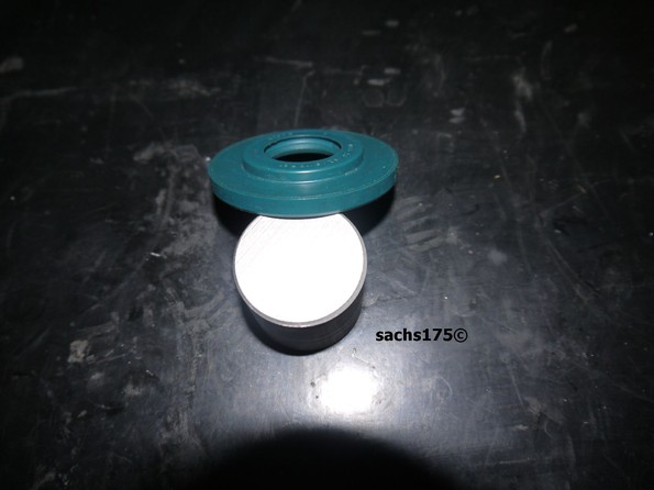

the new alternative and no overhang by a seal by using a spacer

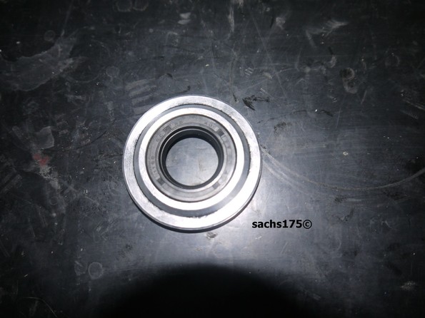

mounted alternative seal housing with new seal
